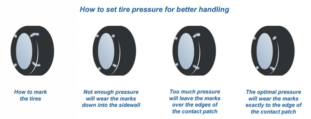

To answer the question, there's a way to find your optimal tire pressure for performance purposes which is fairly simple and only requires you to have white shoe polish and an accurate tire gauge
- How to set tire pressure for better handling
The idea is to use the maximum width of the contact patch WITHOUT rolling on the sidewall, this will give you the optimal performance from the tires
.You'll want to do this test in a deserted parking lot or something in that nature, just in order to be able to turn the car to different directions
First off, you need your tires to be filled up ~4-5 psi higher than the , manufacturer's recommendation, next - mark the tires with white shoe polish from the sidewall to the contact patch as shown in the picture, mark 3-4 times with even gap between them
.In order to be consistent, let's say that all tires will be set in the exact X psi higher than the manufacturer recommendation
Now, get in your car and drive it in low to moderate speed turning to both directions, 8 figures will do just fine too, but try to cut the corners fairly smooth and not cranking the wheel... after you've driven the car for about 60 seconds and turned it to both directions about the same amount of times, stop the car and measure the tire pressures immediately, now look at the shoe polish marks - do they get exactly to the edge of the contact patch? are they not getting exactly to the edge? are they rolling over the edge? here's what it means
Marks that are worn down into the sidewall mean that the pressure isn't high enough, marks that are not worn all the way to the edge of the contact patch mean that that pressure is too high and marks that are worn down exactly to the edge mean that you just found the optimal pressure of your tires
Repeat the experiment according to the results you've got - lowering or raising the pressures as need and don't forget to mark the tires again, all while keeping close notice of the tire pressures changes, most chances that you'll find out that the best tire pressure for handling will be 3-5 psi higher than the manufacturer's recommendation, and keep in mind that hot tire pressures are a bit higher, so keep in mind that the cold pressures will need to be a tick lower
.Moti
