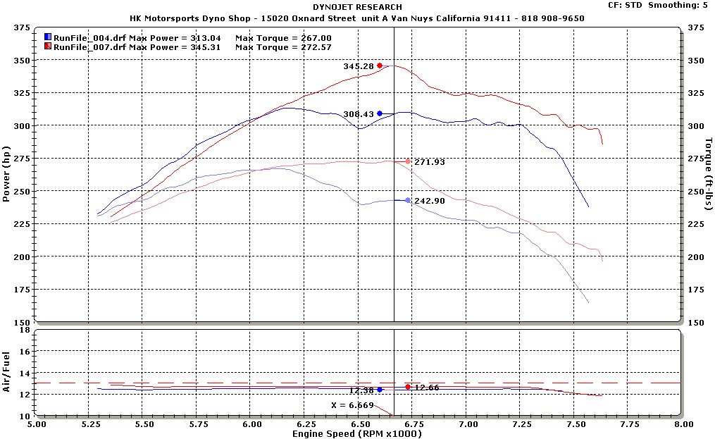

Dynos without Water And Meth:
First Pull yeilded 310WHP
See here:
Video Here:
2 Pulls later heat soaked the Eliminator kit did 294 WHP.
EVERYTHING BELOW IS USING WATER & METH
So we had run the car 4 times it was time to just add water and methonal to the mix to see what would happen! This brought us up to 313WHP just after the car was at 294 without adding water and meth..
See the video here:
Okay now lets bump this mutha's timing up and see where it gets us...
So there ya have it!!!!
I did say that this car was around 340-350 and I was correct! The Water and Meth allowed us to really push this thing and we gained some serious HP on this kit from the heat soaked run of 294WHP to 345 WHP!!! THATS 51 WHP AS A RESULT OF THE WAI!!!!!!! embeer.gif
