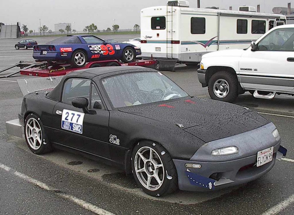

I'm not all about theory, I have removed from my miata (BTW a very small car too, Roni) about 118 Kg and the difference is very noticeable, the car accelerates quicker (it was already a monster before though), the brakes are much better and cornering speeds are substentially higher, this is a big improvement and I'd take it any day over 15 HP more... The problem is, as Roni mentioned, that you have to do some radical stuff to remove 100 Kg off a small car like a Clio... Lightweight wheels are the first thing that comes to mind, it is also unsprung weight AND rotational mass which has even a greater effect of weight removal because it allows the suspension to work with higher precision since there's less weight to carry over bumps and such

Take a look at the picture I added to the post - you take white shoe polish
and mark the tires in 4-5 place from the tread to the sidewall, fill up the tires as per the manufacturer's recommendation, go take a ride around the block with a few hard corners to the left and the right, now inspect your tires and the marks - are the marks worn to the corner between the sidewall the tread? are they worn onto the sidewall (most chances they are)? are they not worn enough andyou're not using the full width of the tread? according to the answer, if the marks you made are worn into the sidewall, fill up your tires a couple PSI's higher, or, if the marks aren't worn enough, reduce the pressure by a couple of PSI's, repeat the test when you have a tire gauge with you and keep marking the tires until you find the exact pressure that your tires are using the full tread but not the sidewall, you will need to monitor that pressure closely during the test but once you have it, you know which is the correct tire pressure that your car handles the best in
