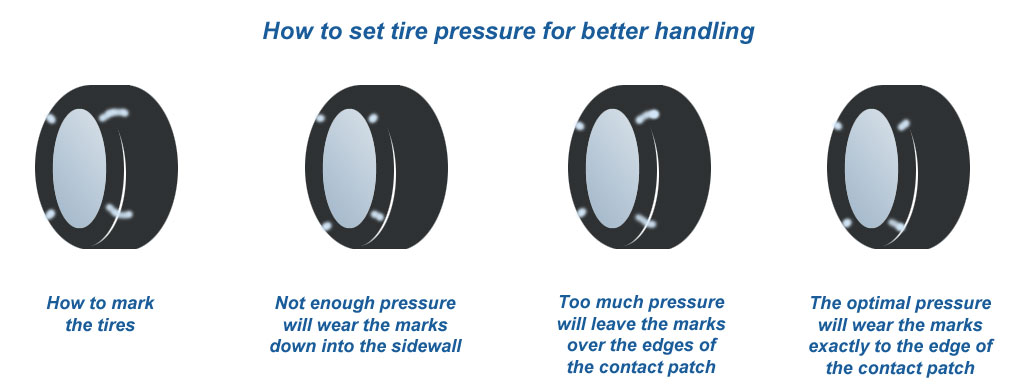

Here's the way to set it up correctly, good for all you guys that are going to do it for the first time or even for all you old timers that don't really give it athought... tire pressure can make a nice improvement on your car's handling
I'd normally start by pumping the tires to about 7-8 psi more than the normal pressure BEFORE I get to the gymkhana area, this is especially good if you don't have a compressor with you to fill them up on site
As I get to the location, I'll go through the tires and check the tire pressures in all tires before my first run, set it to about 4 or 5 psi more than the normal recommended pressure consistently between all the tires, and them mark all of them with white shoe polish as the explanation says, this is a quote from another thread
- Quote begins
There's a way to find your optimal tire pressure for performance purposes which is fairly simple and only requires you to have white shoe polish and an accurate tire gauge
- How to set tire pressure for better handling
The idea is to use the maximum width of the contact patch WITHOUT rolling on the sidewall, this will give you the optimal performance from the tires
.You'll want to do this test in a deserted parking lot or something in that nature, just in order to be able to turn the car to different directions
First off, you need your tires to be filled up ~4-5 psi higher than the , manufacturer's recommendation, next - mark the tires with white shoe polish from the sidewall to the contact patch as shown in the picture, mark 3-4 times with even gap between them
.In order to be consistent, let's say that all tires will be set in the exact X psi higher than the manufacturer recommendation
Now, get in your car and drive it in low to moderate speed turning to both directions, 8 figures will do just fine too, but try to cut the corners fairly smooth and not cranking the wheel... after you've driven the car for about 60 seconds and turned it to both directions about the same amount of times, stop the car and measure the tire pressures immediately, now look at the shoe polish marks - do they get exactly to the edge of the contact patch? are they not getting exactly to the edge? are they rolling over the edge? here's what it means
Marks that are worn down into the sidewall mean that the pressure isn't high enough, marks that are not worn all the way to the edge of the contact patch mean that that pressure is too high and marks that are worn down exactly to the edge mean that you just found the optimal pressure of your tires
Repeat the experiment according to the results you've got - lowering or raising the pressures as need and don't forget to mark the tires again, all while keeping close notice of the tire pressures changes, most chances that you'll find out that the best tire pressure for handling will be 3-5 psi higher than the manufacturer's recommendation, and keep in mind that hot tire pressures are a bit higher, so keep in mind that the cold pressures will need to be a tick lower
.Quote ends
This obviously discusses the settings as an experiment, what I will do, as well as just about any person that cares about the consistent performance of his car between the different runs, is to set the correct tire pressure again before EACH RUN according to the results that you got from the previous run, keeping in mind that it might require completely different pressure in each tire
- For example
Let's say you tested your car, and instead of the manufacturer's recommendation for 31psi all around in your tires you found out that it's better balanced when the pressures are 34psi in the front and 32psi in the back, now you start your runs in the gymkhana with those pressures in your tires, but out of 20 corners 14 are to the right, meaning that right after your runs you might find out that the pressures have changed to 37psi in the LEFT front tire, 35.5psi in the RIGHT front tire, 34.5psi in the LEFT REAR tire and 33psi in the RIGHT REAR tire
It's easy to see that the left side tires carry most of the load in this example, and for the next run I'll set the tire pressures again, this time filling up the left side tires a bit less to have them going back to their optimal pressure for longer period of time during the run, something like 33psi in the Left front, 34psi in the right front, 31psi in the LEFT rear and 32psi in the right rear
This may sound like a little too much but in reality setting the tire pressures takes only a few seconds, it is espacially easy if you have a tire pressure gauge with a built in bleeder valve as most of the good ones do have it
:smile: Diagrams attached for easier visualization, hope you'll find it helpful
.Moti
אם אני סתם אנפח את הצמיגים ב3-4 PSI יותר זה גם יעזור, נכון?
