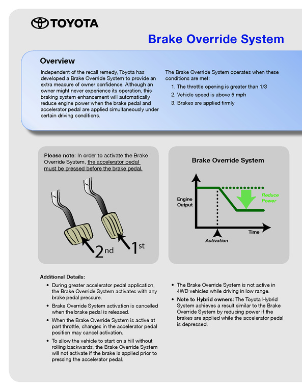

http://www.thetruthaboutcars.com/wp-content/uploads/2014/02/37146460.png
טוב שטויוטה הוסיפה מערכת כמצויר, שתפחית את כוח המנוע כאשר לוחצים על דוושות התאוצה והבלימה בו זמנית. חבל שלא עשו זאת קודם.
מענין מה היו הסיבות להאצה הלא רצויה הזו.
What Causes “Sudden Unintended Acceleration” ?
Floor Mats?
While the floor mat being inadvertently pressed against the accelerator pedal could definitely cause “Sudden Unintended Acceleration,” “blaming the driver” is a typical auto manufacturer’s defense whenever the issue of a defect in design or manufacture arises. However, just because the floor mat may have slid forward and interfered with the accelerator - this does not mean the manufacturer is absolved of liability for a design defect.
Electrical Interference?
Technological development and innovation continues at lightspeed. The multitude of electronic functions that vehicles are equipped with is ever increasing. However, there is a direct correlation between the number of electronic functions in a motor vehicle and the number of defects. Electronic throttle controls have been problematic. Pedal sensors, supposedly designed to detect problems often mask them. Electromagnetic interference, or electromagnetic incompatibility occurs when one electrical system interferes with another, and can causes failure(s) of electrical components.
Throttle Shaft?
Rumors have arisen that Toyota has been aware of problems with cracked throttle body shafts in their vehicles for years. The effect of a broken throttle shaft is no throttle control whatsoever and potential wide open acceleration.
