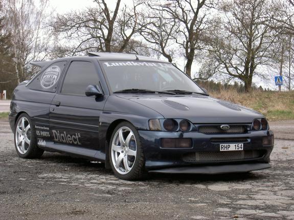

פרוייקט אסקורט קוזוור'ת 734 כ"ס, 2.8 שניות למאה,(יש גם סרטים על מסלול המראה)

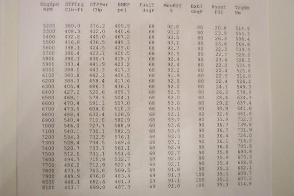

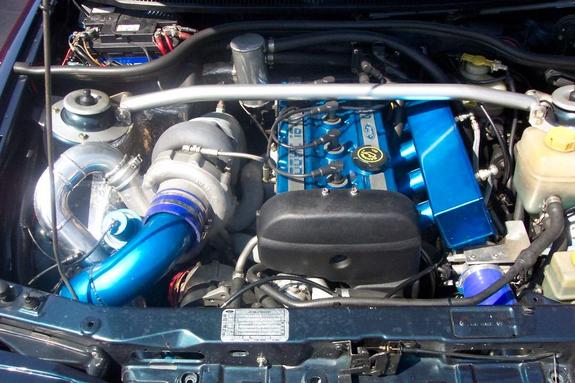

Engine: Cosworth 2.0 16v engine
200block (O-Ringat).
Standard compression.
Burton connecting rods (weighted).
Venolia piston whit “total seal” piston ring (weighted).
Standard crankshaft (Balance).
Upgrade oil pump.
Max machined cylinder head.
Mechanical valve lifters.
Harder valve spring.
Special cam shaft.
Adjustable cam gear.
Special intake and exhaust manifold.
Flow prepped Garrett GT 42 turbo.
Special wastegate (Big!!!).
Hestec (Engine Management System).
Msd Racing 1200cc injectors.
Fuel system rebuilt whit 3 fuel pumps and catch tank.
Forge Motorsport Intercooler.
Power: 734.5 bhp, 760nm at 7300 rpm and boost 2.45 bar
Performance: 1/4 mile 10,75/215.4 km/h
Gearbox: fixit gearbox
Clutch: double-disc Saschs
Back Diff: Original difference
Front Diff: Original reinforced
Bussings: poleruthan
Shocks: Yellow bilstein
Wheels: ACE DINO 7.5 x 18
Tires: Yokohama Advan 0048 225-40-18
Brakes: Bremsport 4 pistons yoke whit 330mm disc (front), standard brakes (bak).

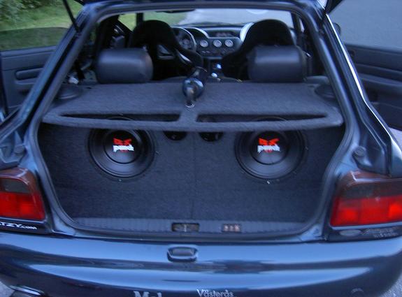

Interior: Momo rally seats, three Autometer gauges, Roller cage according to Bilsport (Swedish) regulations.
A MACHINE , KEPT ALIVE BY HIS LOVE
