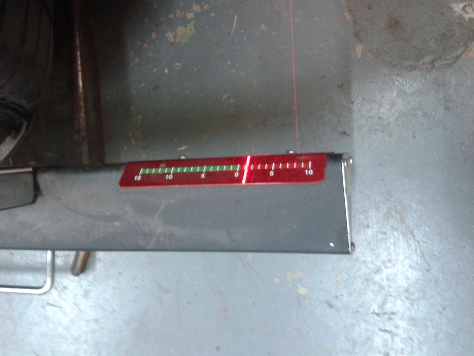

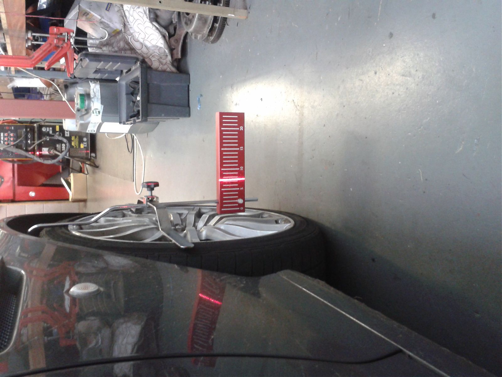

I serviced this fine motor a 20K mile service. Part of the service is a wheel alignment check, I was amazed at how the car was within all factory specs
Not only that it was also the same side to side. pretty good for the brits!
I decided to put 4 tyres on it too. it wasn't too bad at around 950 pounds for tyres alone

Generally the lasers project the rear wheel faces to the front wheels indicating a datum point that is then checked against manufacturer specs.
The rest is standard wheel alignment, the lasers project the wheel faces to measure toe in /out and a clever gyroscopic devices can be fitted via magnet to the wheel face to measure camber on all four wheels and castor (on the front obviously) tool is expensive (around 2.5K gbp) but it makes checking alignment quite easy.
