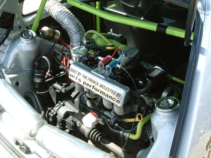

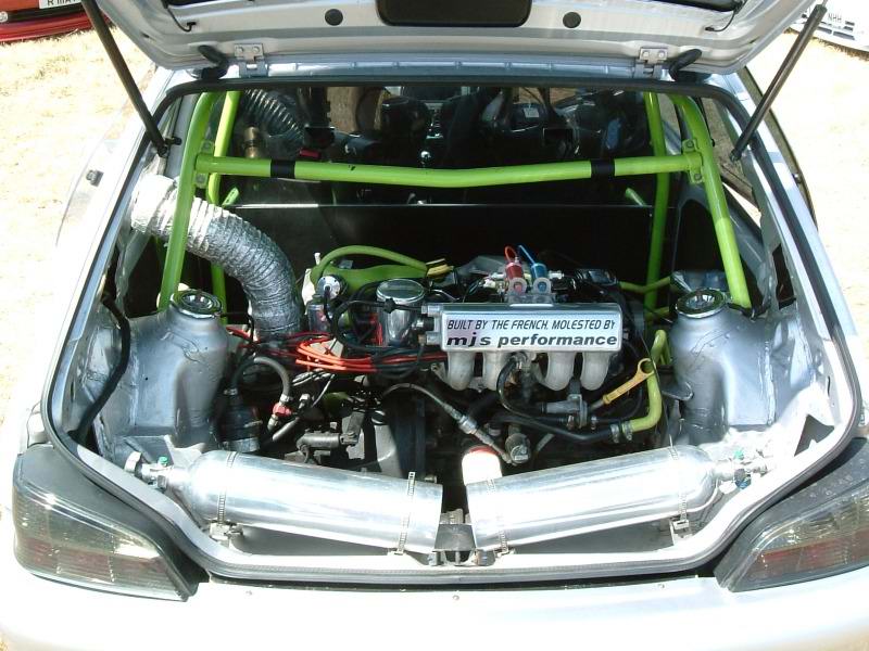

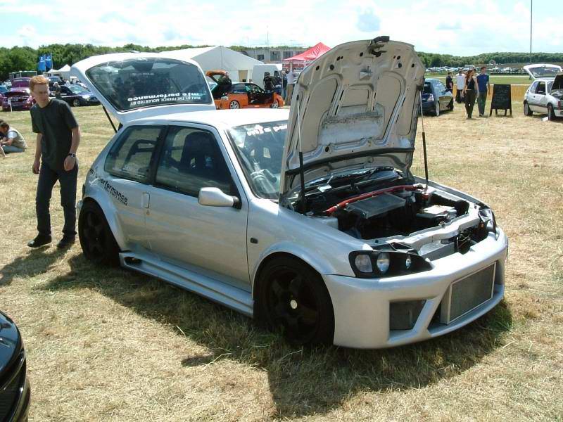

rsturbo 1600cc engine transplant into rear of vehicle!! rear engined, rear wheel drive
few engine mods pushing power to appx 230bhp
garret t3 hybrid turbo
ported and polished head
kent cam
vernier pulley
7:1 compression mahle pistons
23 psi ecu with superchip
ap paddle race clutch, seat leon hydraulic clutch pedal assembly &metro slave cylinder
samco green turbo and water hoses
pace chargecooler
bailey motorsport header tank and swirl pot
bailey motorsport piston dump valve
standard rst gearbox with lsd
knife edge crank
lightened and balanced flywheel
all bottom end components lightened and balanced
100bhp nos
tiger sport exhaust rear box with magnex dow pipe
SUSPENSION
up front ive got H&R peugeot coilovers
avo escort coilovers on rear
peugeot strutt brace at front
car is lowered 75mm
WHEELS
compomotive MO 17 x 8 in matt black
215/40/17 avon tyres
BRAKES
288mm big brake conversion on front,
315 mm big brake conversion on rear
willwood 4 pot callipers all round
hydraulic handbrake
bias brake control (front/rear)
BODYWORK
carzone front and rear bumpers
carzone side skirts
cittuning saxo f2 arch extensions, fronts fitted to rear and rears fitted to front!!
scooby bonnet scoop
windows tinted
lexus style rear light clusters
INTERIOR
sparco evo seats
sparco harnesses
sparco steering wheel
sparco gear knob
sparco pedals
one off custom built rollcage in same colour as samco hoses
rev counter with shift light
boost gauge
oil temp gauge
oil pressure gauge
water temp gauge
(all gauges mounted in one off pod)
carbon fibre front door cards
carbon fibre rear inserts
removeable vinyl coated mdf with perspec top, driver/engine divider
one off ally petrol tank situated under bonnet!

זה ממש לא השלדה של 106GTI - שימו לב למתלים האחוריים ולבולמים איך החיבור לשלדה והזוית.
נראה כי כל החלק האחורי שונה, מרוב שמהרתי לתמונות לא קראתי הכל - זה 4על4 ????
החלק האחורי(המתלים) מזכיר במשהו את מבנה VISA אלף המסלולים 4*4
אם זה 4*4 אמיתי - סוף סוף פז'ו מוצאים משהו נחמד באמת - זה מפז'ו? סדנא פרטית?
