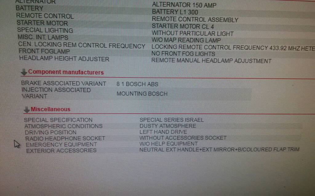

כך נראה רישום VIN מפורט, של BMW - המוזמן לישראל.
BMW vehicle option codes VIN
Market versions for Asia, the Carribbean, and other Tropical countries
were assigned option code - 823 the Exports data line
808 - Israel Export
823 - Tropical Countries Export
