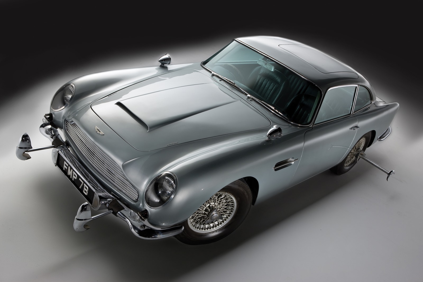

010610rm_LF10_r101_58.jpg60777mee-Aston Martin DB5 - 007 car.jpg64962bea-Aston Martin DB5 from Goldeneye.jpg
