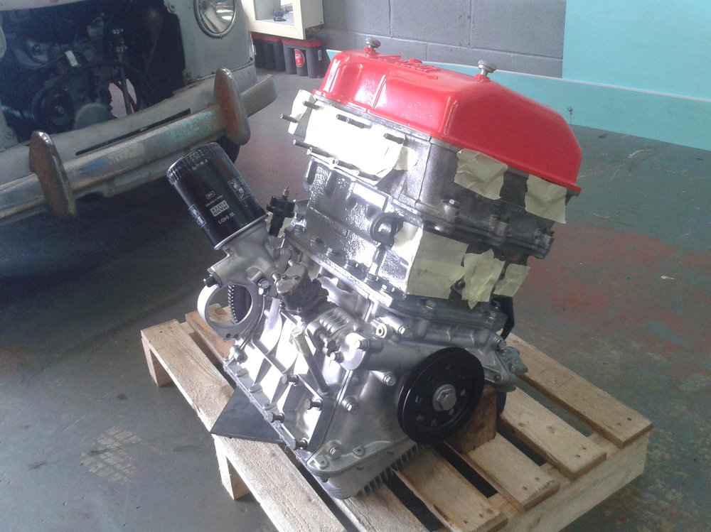

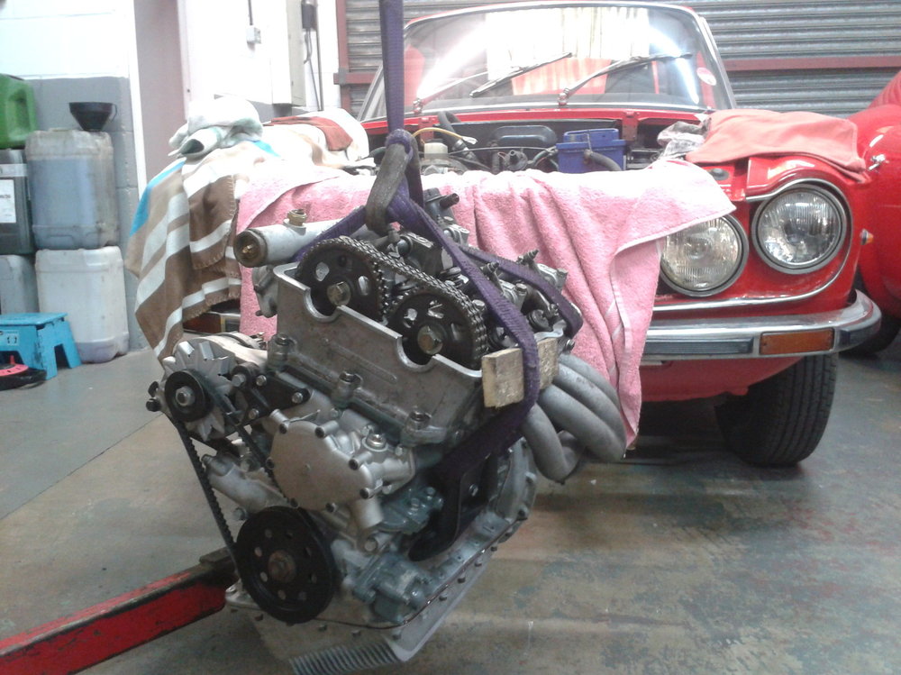

Engine going back in

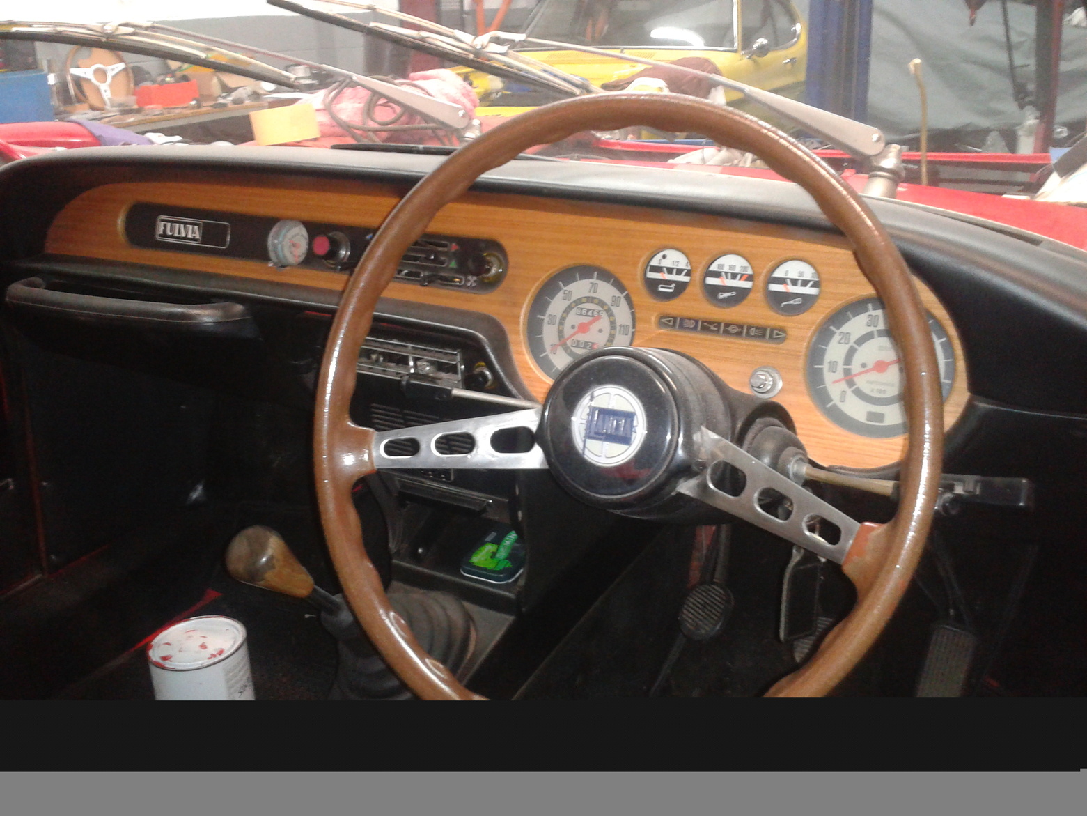

I have added a picture of the Fulvia with steering wheel on the ''other'' side to me they are all cars now no matter where the steering wheel is. I still remember when a RHD seemed less of a car to me, as if it was flawed or damaged somehow.
