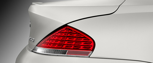

Effective spoilers can be really small and un-noticeable, a lot of cars already come from the factory with a trunk lid that is shaped like, see for example the BMW 6-series
.Moti
