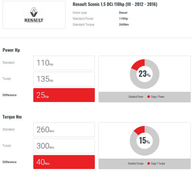

על Upsolute לא שמעת ?!
http://www.upsolute.com/en/chiptuning/db/car/3799/renault/scenic-3/renault-scenic-3-dci-15-110
