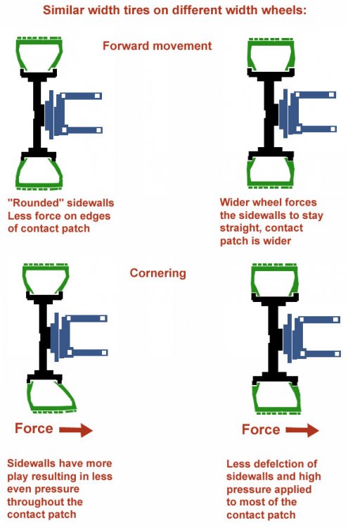

Exactly, that's the number one reason that when you upgrade the wheels to make the car handle better you should upgrade the width, as wider wheel forces the sidewall to deflect less

Read the question again, I asked for the width measurement of the wheel itself, not the tire.... I'm willing to bet it's a 6.5" wide wheel
Anyways, 225/45R17 can improve the performance over a 205/55R16 because
it will come on a wider wheel, normally 7" wide... but if you really want to maximize the performance I would go with 225/50R16 on a wide wheel - probably 7.5" or 8" wide
