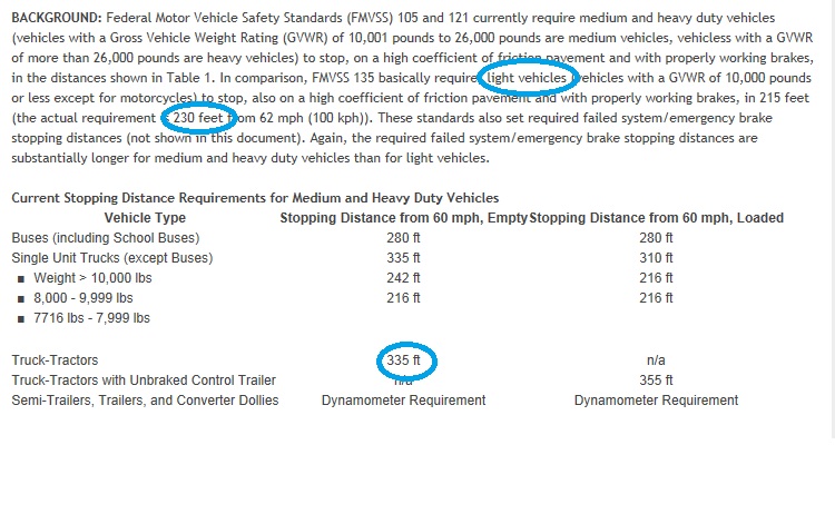

  11. http://www.nhtsa.gov/Research/Crash+Avoidance/Heavy+Truck+Research
