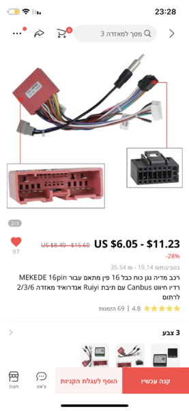

  10. https://he.aliexpress.com/item/33039634228.html?spm=a2g0o.productlist.0.0.65e428199slgLI&algo_pvid=34a78a4a-32da-4f54-ba0d-ba2fafc5c912&algo_expid=34a78a4a-32da-4f54-ba0d-ba2fafc5c912-17&btsid=2100bdd816142840616966108e4c42&ws_ab_test=searchweb0_0,searchweb201602_,searchweb201603_ מתאם למערכת המקורית
