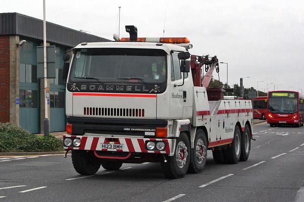

  2. Well, there were 8X4 Scammells like these in Israel - they stopped bringing them because when DAF bought Leyland in the late 1980s they killed all the heavy Leyland/Scammell trucks (T45 and S26) - the wrecker in the pic was supposed to go to Israel but for some reason the order got cancelled, which probably saved its life, hahaha. I don't know if any are left in Israel with registration/test anymore... Freightliners I though there are still some working, so maybe you can get in touch with owners for the time they want to sell - they cannot be worth that much? Crazy ministry of transaport rules:cry: I remember this nonsense when I used to live in Israel... Congratulations for saving the Leylands, by the way. All the best, T PS: I saw a few entries back you were asking about KAMAZ - well, I remember there was one in Hadera in the the 1980s, it was owned by an oleh hadash who used it to do general transport. It was blue and don't ask me how he got parts for the engine at that time - now it's no problems, of course and you can get JaMZ bits for nothing in Russia:-) The pic is from Denisovets' site (with a pic of the better looking prototype also): http://denisovets.narod.ru/kamaz/kamazpages/kamaz5320.htm Main page: http://denisovets.narod.ru/models.html
  3. Genadi, just for interest's sake, what kind of a truck is the 400 of - cannot be that old (late 1980s? I don't think the Cummins 400 came out before that time)? Is this by any chance a Scammell (like in the pic - this one is a cancelled Israeli order, now in use by Heathrow airport) or is it a US made truck? Thanks, T
